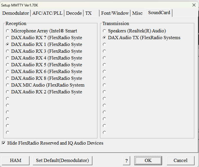

    Are you definitely transmitting? You can see the signal on the panadapter in SmartSDR?
    Sometimes with MMTTY the TX channel resets so then it doesn't actually transmit.
    Make sure you have DAX Audio TX set for transmission in MMTTY.

    Rich…Thanks for that but, yes, I am transmitting, I have no trouble completing contacts.
