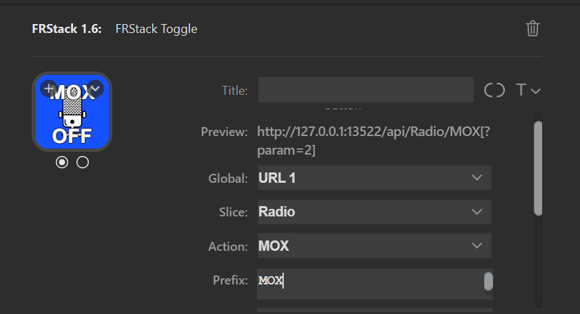

I am trying to get FRStack and the Stream Deck Pedal to work with MOX. Currently, out of the box config, the Pedal will do MOX but only as a toggle between on and off. From the FRStack documentation, I think I want a HOLD instead of Toggle. What I dont see is how to do this via the api configuration of the stream deck pedal. Below is how it is currently configured.
But I dont see where to change toggle to hold. I did try with slicemaster and its stream deck profiles and it works fine. However, I do not want to have to run both frstack and slicemaster, I would rather just use frstack. Is there documentatioin on the api side of frstack?

ok, I think I have figured it out. The toggle button is what is defined so that is what it is. What I think I need the the "state" button which has action when pressed and action when released.
I will test this out tonight and see how it goes
yes. You define the “on” state and “off” state with the FRStack commands for MOX on and off.
