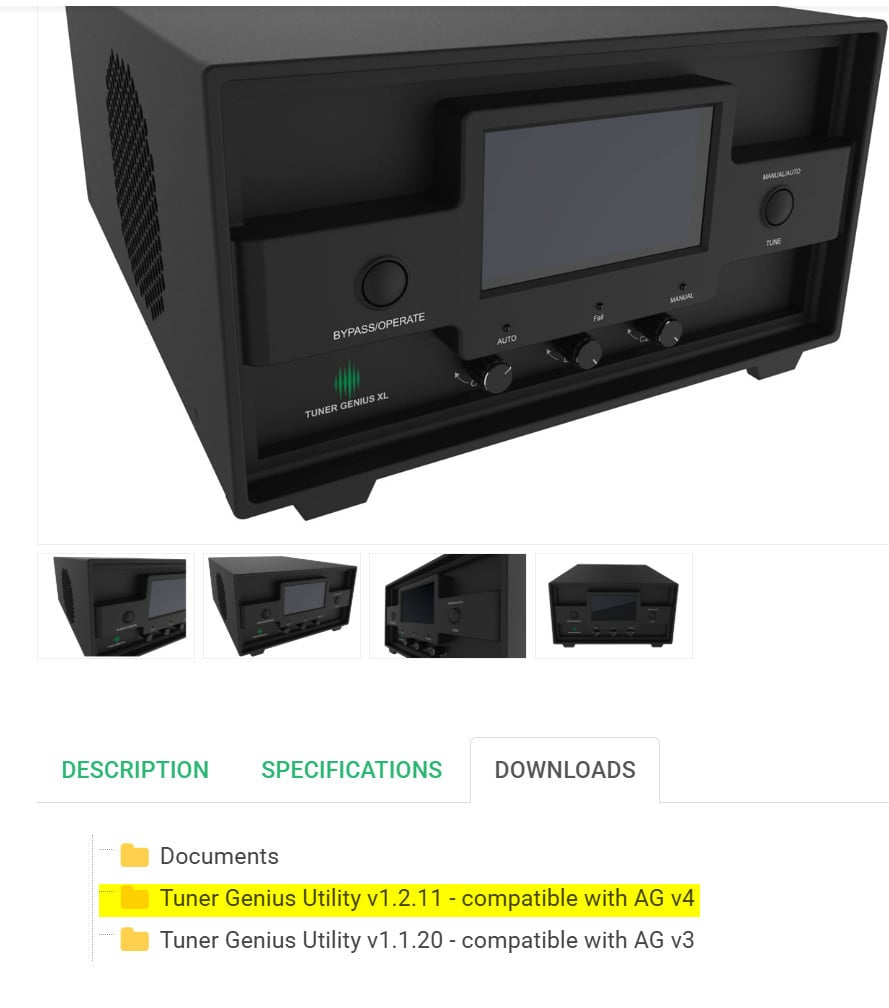

TGXL integration with SmartSDR v3.9.18
Please disregard. I did not see I needed the new firmware0
FYI - the new required TGXL version is not currently available here or on 4o3a. Here is the 4o3a downloads.
Regards, Al / NN4ZZ

came to say the same
The TGXL v1.2.17 firmware is now available on the 4O3A website here:
