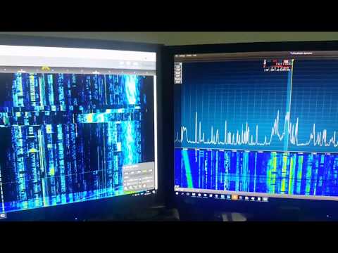

Spend another couple of hours to get a small websocket based client working, based on flexlib-go. Hardest part is opus decoding/resampling inside the browser. Prototype shows, that it is perfectly possible to create a standalong multiuser HTML5 radio client. Also the OpenWebRx/IQ-Stream things are covered in the following video:
