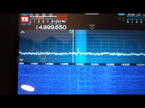

I have also had reference selection problems. This is with GPSDO installed. With good sat lock in GPS, my 6500 drops sync and starts free running (as it seems) for a second before locking again. Check my video at
https://youtu.be/UzhlkAokKAQ . Rig is unusable when this starts. It has gone back to Austin, where it's been sitting for 3 weeks now. (Hint to mgt.) 0 -
