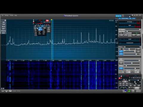

I cannot reproduce that behavior. Changing CWL or CWU does not change the mode of the active (and only) slice I have defined.0
As you can see in the video, It doesn't change the mode, it moves the pass band from one side to the other,... but only visually, because you can still hear the station and that would be impossible if it was on USB. If I change USB to LSB mode the behavior is normal.0

Please check the video above and look around 15 seconds into the video. Changing CWU to CWL in the Setup menu changes the passband left and right even though the mode is still LSB.0
Salvador:
I see what you are saying.
At 15 seconds you have set your mode to LSB. The filter is showing on the left side of the line. So far so good. Then you go to Radio Setup -> Phone/CW and you change between CWU and CWL and I see your filter area move above and below the line while LSB is still selected. I see your filter Cf move between -1.0K and 1.0K. Yes, this is weird and unexpected behavior I think. How?
Mine is not doing the same thing. I'm set for LSB. I see the shaded filter area to the left of the line. When I change Radio Setup -> Phone/CW sideband between CWU and CWL (back and forth) nothing changes in SSDR. The shaded filter area remains to the left, normal LSB. It behaves as expected. In fact, even when I'm in CW mode I don't see the filter jumping to the other side of the line.
I tried to match your settings in the video as much as possible and I can't seem to get the results you are seeing.

Try modifying the cw pitch value to 400 or even 300. Then go to lsb and try switching between cwu and cwl, see if it happens then.0
UPDATE
Good news is that a brand new install of SmartSDR, a factory reset of the 6700 and removing all my profiles fixed the problem.
Bad news is that I have to recreate all the profiles, memories, MIC adjustments, etc... painful.
At least I am not getting the weird behavior of switching left and right on LSB when selecting CWU or CWL and it is back to behaving properly.
