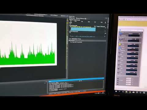

    Maybe the wrong thread, but I've at least managed to get some kind of sound. Here is a recording: https://drive.google.com/file/d/0BwuiePIG9KVMc3pWR0FVb3VSRm8/view
    I've tried with both channels, speed is fine, but tone frequency is too high. Then isolated one cannel deinterleaved  (See screenshot) with the same results.... tone freq is strange.
    Olso tried to import the raw bytes with audacity... same sound / [noise]
    When I enable SmartSDR Dax on the same channel I hear the sound in sync, but dax has the right tone freq :) According to https://community.flexradio.com/flexradio/topics/iq_stream_from_6700_radio the Sample Radio of DAX Audio is 48k.
    Does anyone see what I'm doing wrong?

    Sorry, dump mistake, I've had two subscriptions to this.stream.RXDataReady... no idea why, but audioStreamAdded might get called twice in 1.6.21??
    If anyone still has suggestions, let me know. the following code should work:

    The code for handling the data looks reasonable to me on a brief look.  I noticed that in this screenshot you show using 24kHz, which I think is the correct rate.  It looks like you are creating a new BufferedWaveProvider on every RxData event received.  This sounds like something you might do once (if _provider is null, perhaps).  Some googling says this may be in NAudio, which I am not all that familiar with.
