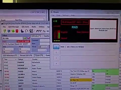

SETTINGS that work for me
Settings > Sound Card > Signal Input > Device > Dax Audio RX1
Settings > Sound Card > Signal Input > Channel > L + R
Settings > Sound Card > Signal Input > Sample Rate > 48000 Hz1 -
Also, here is a video with those settings receiving a New Zealand DRM station with a Signal of 5 from Barbados.
For the file above to work make sure to just place it in the same folder as the DREAM executable.1 -
