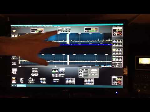

Thanks to FlexRadio Systems for making the PowerSDR source code available to those of us who continue to enjoy using PowerSDR with the "Legacy" FlexRadios 1500, 3000 and 5000.
Darrin Kohn KE9NS offers on his web page http://www.ke9ns.com/flexpage.html downloads of new revisions to PowerSDR that correct the VHF S-meter issue and that fix and add other features.
https://www.youtube.com/watch?v=Ognskm5nEDo
to PowerSDR 2.7.2
