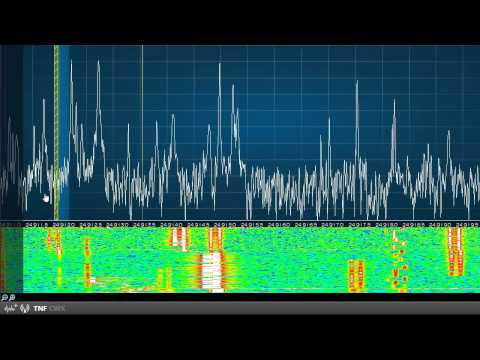

I am very frustrated at this time to this **** problem that this version 1.3.8 I have a graphics card I think my graphics card is good ATI Readon 6700 with 1GB of DDR5 RAM but I notice when I activate the second RX starts to go jerky , its functionality is being slooly, the spectrum is a disaster, the waterfall has black lines, the TX and RX is not synchronized, the program disconnects and closes the dialog box asking me to reconnect to my flex-6500, we still have to wait for you to perquanto we can use decently this "gem" I'm tired of this .... sorry my outlet .... Look at this video uploaded youtube and tell me if this is normal!
https://www.youtube.com/watch?v=cKRZwlCJlgE

    Revert back to v1.3.0 and see if the problem still exists.  We have acknowledged a problem with display rendering in v1.3.8 that we are working on for v1.4

    Reverted back to V1.3.0.  It worked!  No dropouts, jitters or holes in the panadapter.
    No disconnects.   Thanks.  Jim - K2JHV
