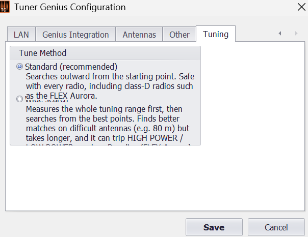

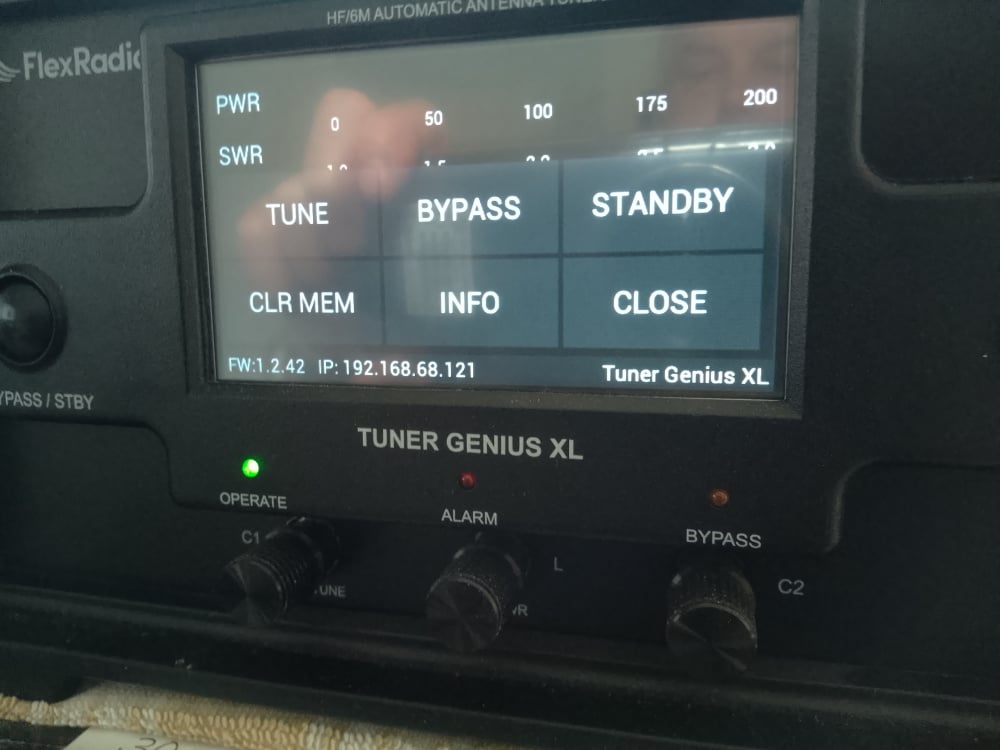

    With the Tuner Genius, it was working perfectly except the touch screen menu was hard to close. With 1.2.42 when the unit is powered on I get 'Touchscreen not Calibrated' and it does not function at all. Also on the 'Other' tab in Device Settings I get
    This is the entirety of it and it is not possible to adjust the size to read the full instruction.

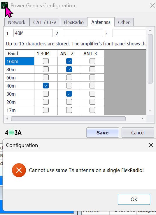

    My PGXL 3-Way works perfectly with the configuration carried forward from the the previous versions. In the Device Settings for 3.9.8 on the 'Other' tab, it looks like it is possible to name the 3 antenna ports. Except that when I try I get this:
    But if I leave the naming boxes blank there is no such error. The configuration without trying to add a name works fine - 160/80/30 are all on the PGXL's port 2 because they are all served from the TGXL. So why is there an issue when adding a name?

    "I get 'Touchscreen not Calibrated' "
    I also briefly got this, so I calibrated my touchscreen:
    • Use rear-panel switch to turn the TGXL off
    • Press-and-hold the right-most "TUNE" button
    • Use rear-panel switch to turn on the TGXL, while continuing to press the "TUNE" button
    • Rather quickly, a blue dot will appear on the screen - this uppper-left blue dot is the first calibration point. You can now release the "TUNE" button
    • Touch this first blue dot, and the succeeding two more (far right edge, bottom center).
    You're done calibrating!

  • Erik Carling EI4KF
    edited October 1
    I suppose it does not really need it. With the 1x3 version it is very handy if the unit is within reach. There is also an additional menu available via the touch screen
    There is another sub-menu, accessed from INFO, split into 4 parts: Links, Channel, Diagnostics, Settings.
