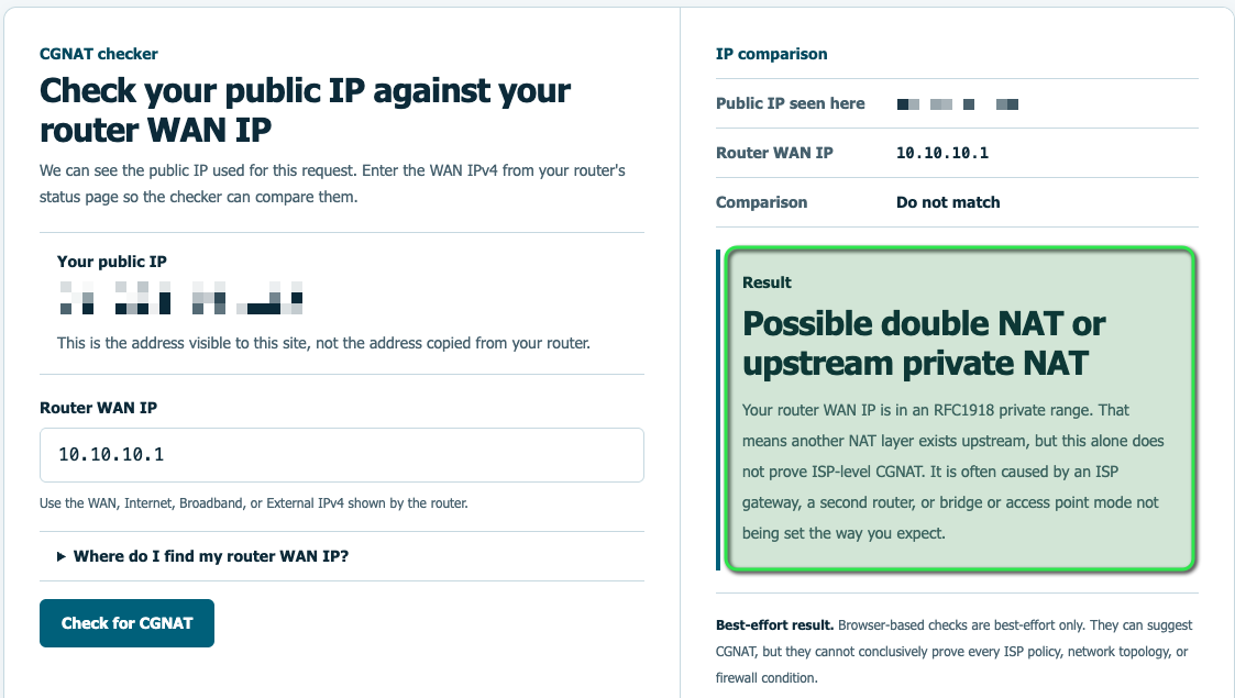

How do I know if my ISP, like StartLink is CGNAT?
If you get this, then SmartLink may not work

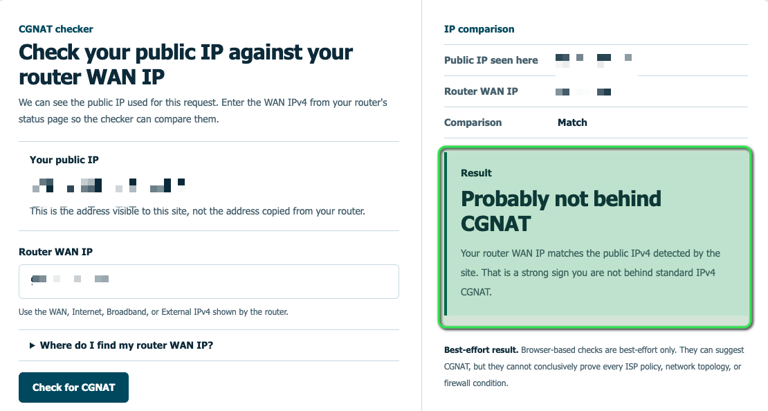

This is what you want to see for SmartLink to work:
If you are using an ISP that is CGNAT and need it to not be for SmartLink, you will likely need to talk to their sales team and see what they charge for a non-CGNAT address (IPv4).
For SmartLink, it does NOT have to be a fixed IPv4, just a non-CGNAT IPv4 address.
