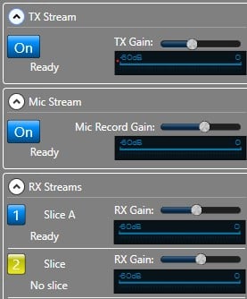

SmartSDRv4.2.20, why no RXstream?
SmartSDR 4.2.20;
Mode: DIGU Radio:FLEX6400
I'm not seeing an RX stream, while Slide A shows a fine signal strength.
In Task Manager DAX processing: 0%
Does anyone recognize this,
see attachments.
Regard, Cees.
Cees,
Ver 4.2.20 of DAX RX will not RX stream unless there is a valid consumer app attached to the DAX port.. The DAX button will also turn green when a valid consumer app attached to the port.
AL, K0VM
See this document:
Adapting to the New Version of SmartSDR with DAXv2 – FlexRadio
Thanks to both of you; that’s exactly what I was looking for. I should be able to manage it now
