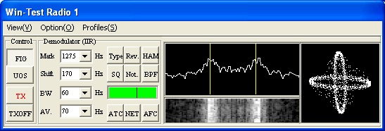

    And, maybe we just use the old method because watching the simulated RTTY scope is cool and we are just old. :)
    That is from the days when we actually had an oscilloscope of the desk to help tune the signals.
