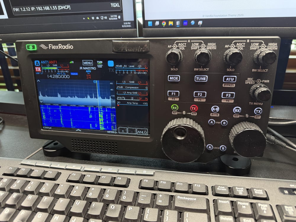

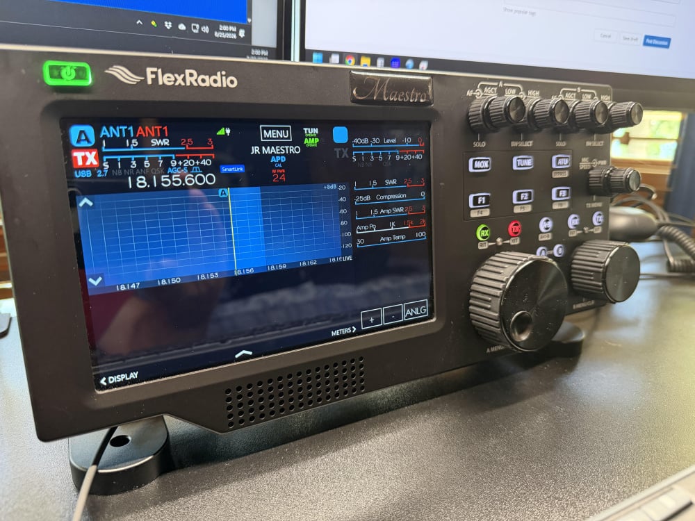

Upgraded to 4.2.2 - No sound or panadapter on Maestro C
After upgrading, no sound or panadapter on the Maestro C.
I've rebooted the 8400 (remotely) and rebooted the Maestro (including disconnecting the power for a few seconds).
4.2.2 is working fine next to the Maestro on the same WiFI network.
I uninstalled all older versions of Smart SDR on the station PC and the remote PC.
I let the Maestro upgrade itself to 4.2.2 and then it did another upgrade after that.
I have not removed older firmware from the Maestro as I don't see that being recommended anywhere.
Hi John, did anything change on your network? Sometimes routers and firewalls try to stop UDP network traffic. UDP is the protocol used for audio, panadapter/waterfall and meter data.
P.S. I have you in my log a couple of times on 40 SSB!
Len,
Yes, it behaved just like SmartSDR on my PC did down in Arizona when I realized my new fiber internet carrier only offers CGNAT, which doesn't work with SmartSDR (So I had to set up a Tailscale VPN).
Having said all that, after a third reboot (and disconnecting the power cord for good measure), the Maestro is working fine now.
Excellent!
