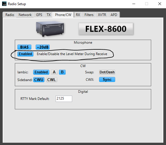

How do you enable the Mic Level display without transmitting? For some reason it seems to be only enabled when the radio is set to 12 Meters and even then, it seems to work occasionally.

If you want to see the signal level, the level meter should be enabled for reception in the radio setup under Phone/CW.

I had it enable in my Maestro but not in Smart SDR, now works properly
