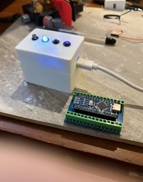

Many of us share our radios with others via SmartLink. If there are multiple shared radios in your network, it is useful to know what radios are active. I manage one for my club that has 3 active radios as well as two other private locations.
This small unit has individual LEDs that illuminate whenever individual radios connected under a common SmartLink account are accessed. It also provides a WIFI connected web page that logs activity by user, etc.
See all radio activity at a glance and if you want more details, open the web page.
With no connection to any PC or via any VPN, this stand-alone unit consists of an Arduino Nano ESP32 and 4 LEDs. Completely stand-alone powered by a USB-C wall wart.
No soldering using the internal breakout board shown.
More details at K9SO.NET. Source code and case .stl files for printing will be provided free of charge to those interested in building one, but I cannot provide support other than what will be posted on K9SO.NET
