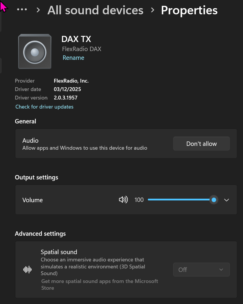

    Just to add, even though an unlikely cause, that with WSJTx running and with 'DAX TX (FlexRadio DAX)' set in Output, that in Windows settings you have the volume slider at 100% - this is the default setting and it should be ok but just in case.

    That was the issue. The output setting in All Sound Devices was set to 31, how that happened, who knows. I set it to 100%
    I can only guess this happened during one of the infamous Windows updates.
    I'm now transmitting a clean signal with DAX TX Gain set at 45%.
